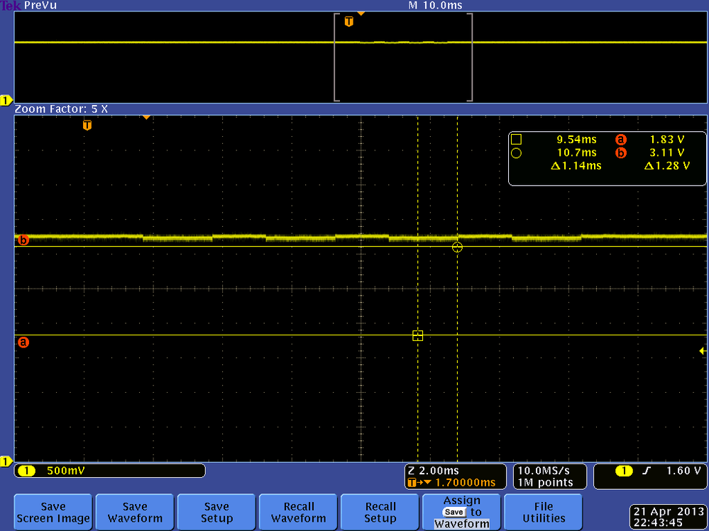

thanks for your reply.I tried to run USART code outside of RTOS. Definitely i dont have any other ideas. Now it doesnt matter if USART1 was used or not. On USART3 RX pin signal looks like its permanently pull-upped. EDIT: Code optimizations are off. I tried to use different versions of code sourcery toolchain. Also i tried to combine USART1 & USART2 and USART2&USART3. Everytime with the same result.STDPeriphLib v3.5.0EDIT2: I forgot to say when USART3 code did not run within RTOS. IT RXNE was never fired. This is image of USART3 RX Pin - Without RTOS. If code run within RTOS and USART1 TX was called, USART3 RX Pin looks same like image above. If USART1 TX not called, signal looks normal.2013-04-21 4:09 PM
Doesn't look like a valid signal, hardly surprising RXNE is not asserting.

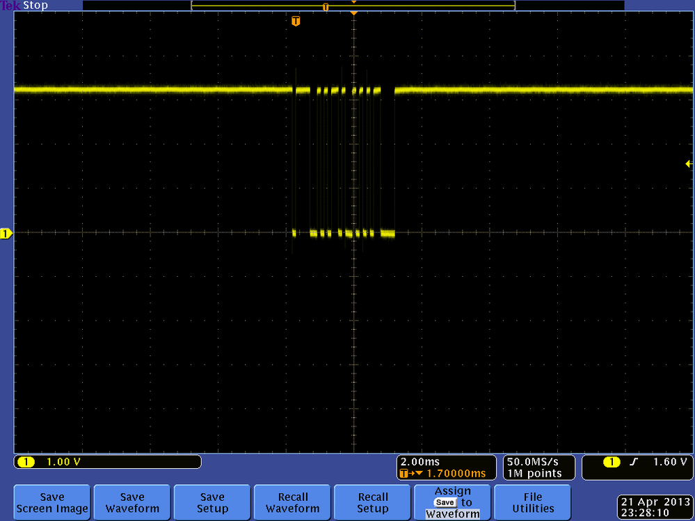

Of course it isn't. And I know that this signal is a reason why RXNE was never asserted. But how did i say before, if i dont send any data over USART1, USART3 works great.
Thanks for your time Clive1.USART3 RX:2013-04-22 4:14 AM
Ok, then perhaps we should be looking at your hardware and not the software. Suggest you describe the chip and board you're using, ideally with a schematic.
