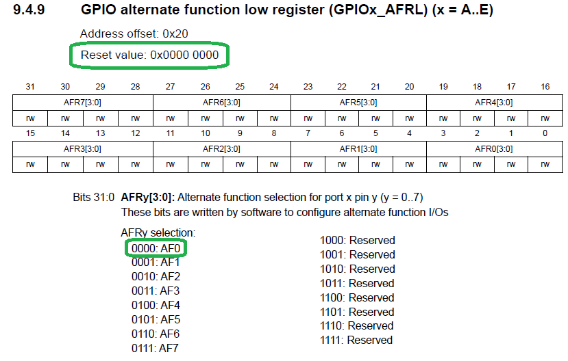

2014-12-25 7:13 PM
Dear Sir
I missed one word of my last postI configured the USART1 for pin PB6 - PB7 and it is working but stranger is it does
NOT
care about following codes
Probably because the reset setting of the bits related to the AF Mux are zeroDear Sir I could not got above Please adviceProbably because the reset setting of the bits related to the AF Mux are zero.
