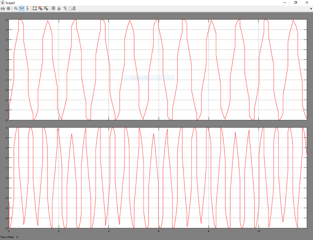

As a result, I get such figures in MATLAB host:
These are sin waves get from another stm. Something like that happens only if I use blocking mode with usart global interrupts (which are not necessary for blocking mode but I need them for DMA and if I have each of modes used in one main program I have to enable the interrupts) or if I wait for clearing one of flags behind the information about transmit complete.
