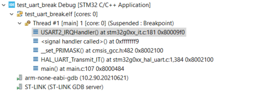

I use STM32G0 and USART2 in IT mode or DMA mode.
When the mcu receive a break command on uart line, he reset after entering on the IRQ handler.
Have you an idea ?
