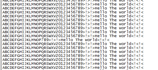

However in receiver device I get several strings like these:
As you can see I missed one of my sending string.Actually I have changed delay between each string and USART baudrate but it shows me the same result. why did I miss some strings during transmission?

2017-03-07 12:27 PM
1)what is my mistake?
Don't use delays, understand when transmission is active, and when it has completed.
Code lacks complete context. You could perhaps use 2 stop bits to improve the synchronization on the receiving side. Use volatile variables as appropriate.
2017-03-07 11:34 PM
Start from a polling example from cube. The code does not tell enough.
I have seen dropped bytes coming from a BT device which converted the UART to BT which is packet oriented: The higher the bit rate the more likely the BT FIFO could get full and trash incoming bytes...
Also, we don't know how you enable interrupts to send a new string. Maybe enable the interrupt AFTER all the global variables are set, otherwise, it could be out of sync. Make sure Counter is not modified elsewhere during the interrupts.
