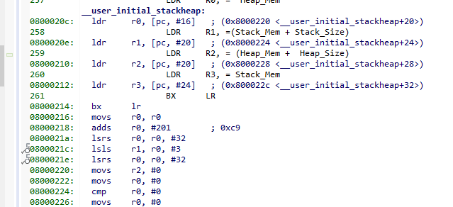

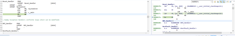

Hi, I notice that when I Load the bin file, the programs works. But It's only when I try to use the debug (with axf file) that I have this error.
Moreover, weird things, is that when I comment one function that use static varible the debug works.
I do not know if this picture can helps you :
The place where the program crash :
The code size :
2017-03-07 8:17 AM
The register content at the faulting instruction would be what you need.
A hard fault handler that isn't a while(1); loop would also be able to provide more diagnostics. See code suggested by Joseph Yiu
Going to suppose this part doesn't have any external memory. Faults typically occur when touching memory that isn't present/decoded.
You could check the stack and heap allocations in the startup_stm32xxxx.s file.
The Cortex-M0 is going to be intolerant of misaligned pointers (ie 32-bit variables at Odd addresses)
