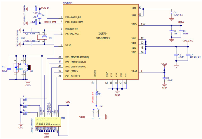

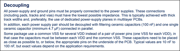

I am currently using STM32H503KBU6 MCU (32 pins). For my project the space in PCB board is critical. I have placed a LDO, Level translator, voltage supervisor and along with their associated passives in a 10mmx16mm PCB board. Now I still need to place three resistor, which I can't able to place because there is no space. My question is that is it necessary to use a high value decoupling capacitor (4.7uF) for VDD and VDDA? Because if I remove those two 4.7uF capacitor, I will get some space to place the three resistors. Kindly give me your thoughts about this. I have attached schematic images which is available in STM website.
Thanks,
Bhavan

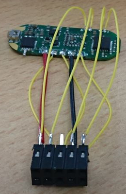

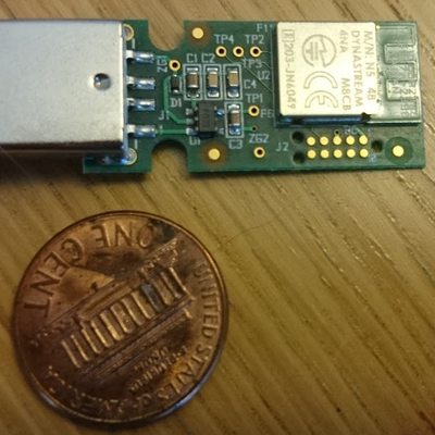

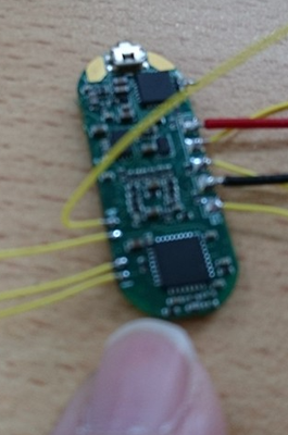

2024-07-03 2:31 AM
@bhavan_kumar wrote:Our MCU has been soldered on the PCB. So, we can't able to directly connect the debugger pin to the MCU
Sure you can:
@bhavan_kumar wrote:In order to connect the debugger pins we need to fan out the respective MCU pins using a 0 ohms resistors.
You don't need zero-ohm resistors to do that.
Just place testpoints; eg,
Or solder fine wires directly:
