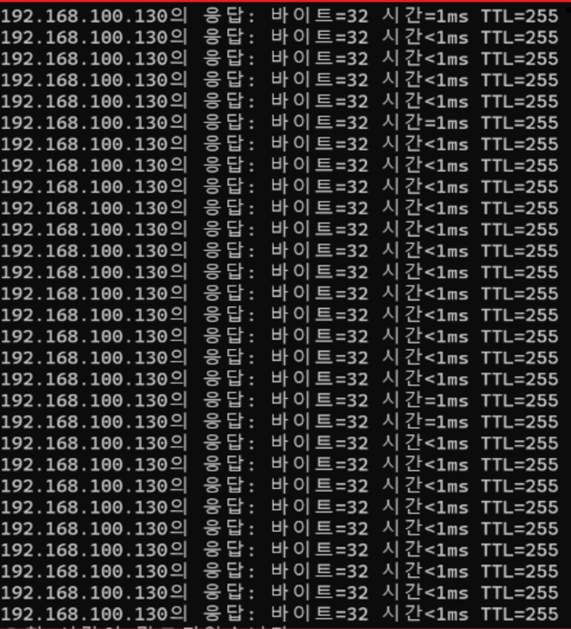

The development device uses stm32f429zit6 and the Ethernet function does not have a DMA function. What is unusual is that when I check the ping response from the CubeMX automatically generated code with the Ethernet function activated without user code, there is a about 1ms response.

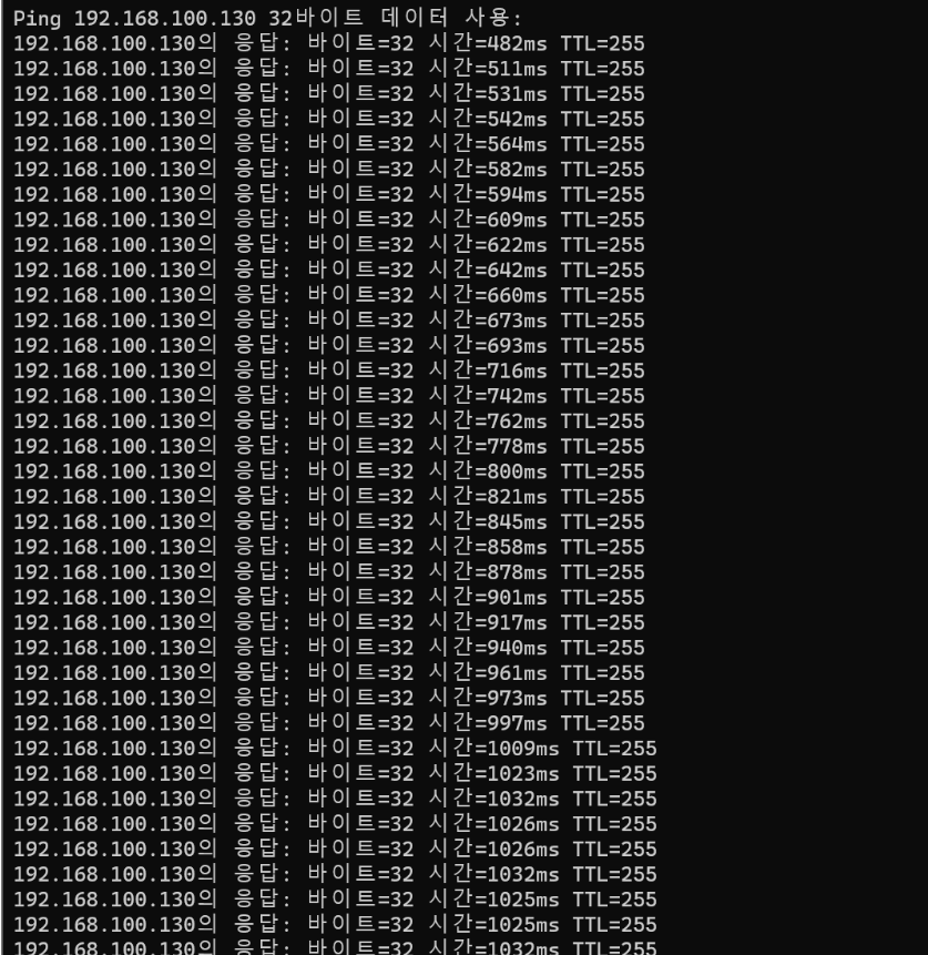

However, after adding user code and operating the development device, the ping response time increases. The ping initial response time increases from about 0.4 seconds and remains at 1.0 seconds. The guess is that the development device may respond in 0.4 seconds, but it appears that some delay factor is accumulating. I am curious as to what causes this behavior.
Use only CubeMX automatically generated code
Use CubeMX automatically generated code + User code

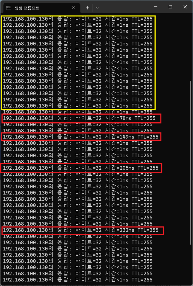

The software I am currently using on your device does not use an RTOS. It is configured to perform serial communication and Ethernet communication functions in a single loop. After removing HAL_Delay(1000), which was used to receive data in the serial communication receiver, the ping command response became 1ms during normal operation of the device, and the overall operation of the device became faster after modification(yellow box log in the attached picture). When the server responded after the required command, the ping response momentarily increased to 78~232ms and then returned to 1ms(red box log in the attached picture).
I am curious as to whether the instantaneous increase in ping response when a server command is something that needs to be improved.
Below is the result of the device's ping response after modifying the code.
