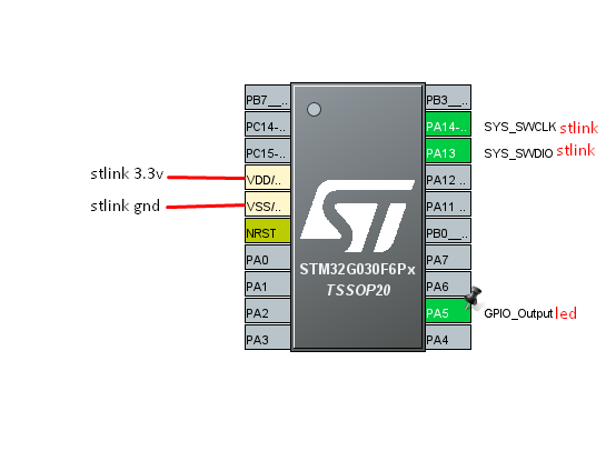

2022-07-28 4:43 AM
I am using st-link v2
I cannot upload the program to the microcontroller
is there any wrong with my design
2022-07-28 4:53 AM
perhaps your board or chip is non functional. What error specifically is reported?
Is the chip powered?
Is it correctly orientated?
Is VTarget of the ST-LINK powered?
Is this an authentic standalone ST-LINK or something else?
If a NUCLEO or DISCO board is the ST-LINK disconnected from the local Target MCU?
I'd connect up NRST.
ST-LINK V2 or V3?
