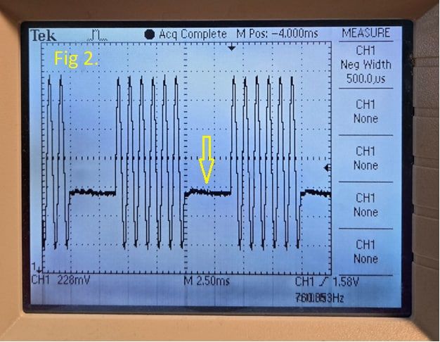

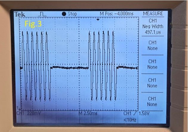

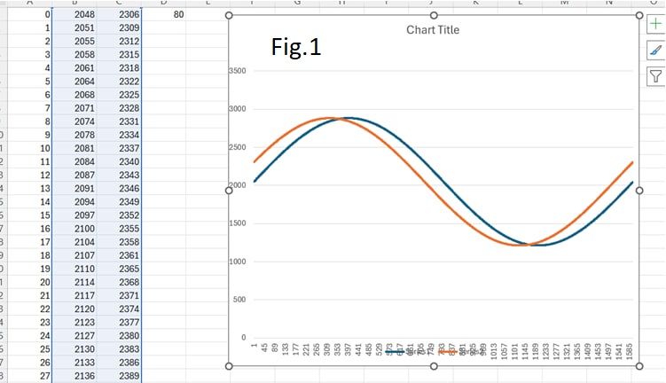

2025-06-15 3:03 PM - edited 2025-06-15 3:10 PM
A related question:
If I supply DMA array 1600 values starting from the exact middle point (blue line on the value chart, Fig.1) then the the output signal starts from a level lower than the middle as on Fig.2.
What is the reason for such behavior?
To return the output signal start to the desired middle level (Fig.3) I have to shift the phase of the input values to the left (red line on the value chart, Fig.1).
