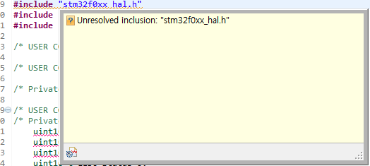

I think you might familiar with this issue if you are proficient user of Eclipse +STM32.
In my #include section of main.c file.Red error line indicates like

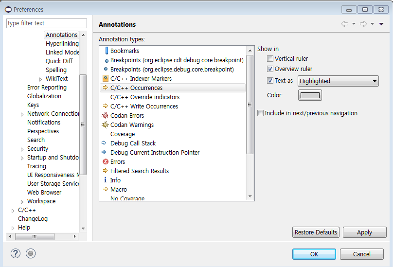

,At the same time the system says to do indexer marker,
Kindly suggest me what to do for this issue?

Hi Mr Seb,
From your experience, could you tell me it should be #include in main.c?
This file exist in my compiler includes,'C:/STM32_toolchain/common/Drivers/STM32F0xx_HAL_Driver/Inc'
In this branch project >> Properties >> C/C++ Build >> Settings >> Tool Settings tab >>MCU GCC Compiler >> Includes
What else in your mind?
If I removestm32f0xx_hal.h reference from main.c, the error minimizes,( 1900 to 600)

2024-07-13 3:49 AM
I had the same problem. For some reason the font chossen, makes it impossible to distinguish between the letter l (l like in liter) and the number 1 (one). So typing the "stm32f0xx_hal.h" did no good. Only copypaste worked. Suspect it is a number one so that it is called "stm32f0xx_ha1.h"
