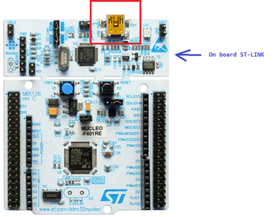

Hello @Odega ,
You still didn't provide what tool you are using to compile the project and to upload it to the MCU.
Example for ST tools:
- STM32CubeIDE: to compile/uploaded and debug available on Linux platform.
- STM32CubeProgrammer: to manipulate the internal/enteral Flash and option bytes.
- On board ST-LINK: as in-circuit debugger and programmer to connect and upload you program to the MCU. USB data cable needs to be connected on CN1 as indicated by the red rectangle.
