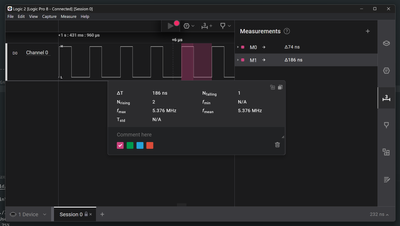

I am confused with pin toggle timings, why I am getting non equal pulse widths like in the picture, I turn off all compiler optimizations and disable all of the interrupts, code is simple pin toggling. My controller is STM32L431 running on 80MHz.
Thank you very much for any advice!

The while(1) is NOT zero overhead. To prove it, try

2024-11-02 11:29 AM
Hi PGump.1
Thank you for your reply,
unfortunatelly still uneven widths..
2024-11-02 4:02 PM
Use a simulator and step through your code at the assembly level, counting the cycles (there should a cycle count visible) - that way you will get to see the "overhead" of the loop. If you want to handcraft a loop with precise timing, you could consider doing it in assembly language.
2024-11-02 4:55 PM
@tompa wrote: "unfortunatelly still uneven widths.."
I never said it would fix it, it would prove it... Was the proof correct?
Kind regards
Pedro
2024-11-02 6:07 PM
Sampling a Nucleo-746RG @80MHz with a Saleae Logic Pro 8 at 500MS/s
Using the same code as the original post. I did not observe the significant difference in width per the first image of the post.
