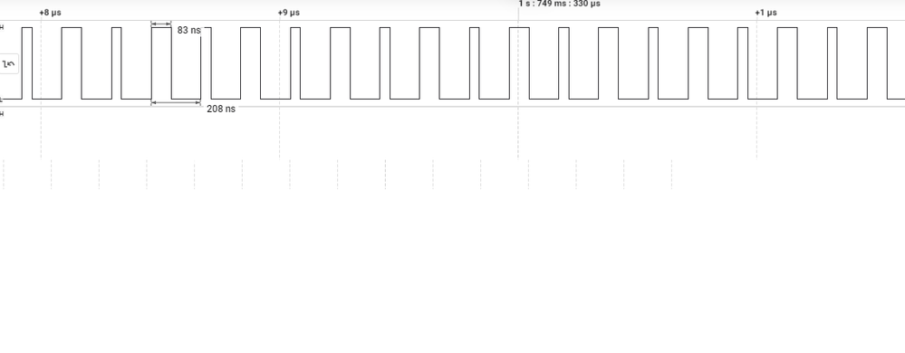

I am confused with pin toggle timings, why I am getting non equal pulse widths like in the picture, I turn off all compiler optimizations and disable all of the interrupts, code is simple pin toggling. My controller is STM32L431 running on 80MHz.
Thank you very much for any advice!
__disable_irq();
while(1) {
GPIOB->BSRR = GPIO_BSRR_BS15;
__NOP();
__NOP();
GPIOB->BSRR = GPIO_BSRR_BR15;
__NOP();
__NOP();

Thank you for your reply, Yes I am using Saleae Logic with 24Ms/s and my signal is 500KHz so I don't think it is a problem. I also check the signal with 70MHz and 2GSa/s Keysight oscilloscope and result is the same...

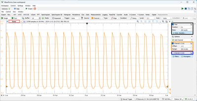

I used a Nucelo-L432KC and a 100 MHz Analog Discovery 3 USB scope. Waveforms look quite regular as expected:
Code was compiled in Release mode. Had to change unavailable PB15 to PB4 and set it to very high speed. Double checked disassembly with >arm-none-eabi-objdump -d build\Release\cycle_timing.elf
The relevant loop is:
800048e: 61a5 str r5, [r4, #24]
8000490: bf00 nop
8000492: bf00 nop
8000494: 61a3 str r3, [r4, #24]
8000496: bf00 nop
8000498: bf00 nop
800049a: e7f8 b.n 800048e <main+0x16e>
The bit masks are pre-computed before the loop.
hth

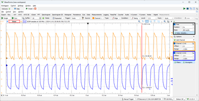

Here is another plot showing PA8 (at very high speed) as master clock output (MCO) with SYSCLK/8 == 10 MHz in blue.
despite the poor signal quality you see that each loop takes 8 cycles. This is consistent with the ARM® Cortex®-M4 Processor Revision: r0p1 Technical Reference Manual if assuming 2 cycles for the branch and one for each other instruction in the loop.
