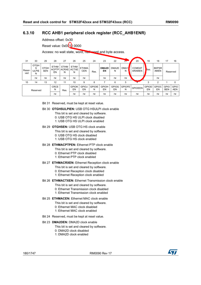

We confirm, the reset value in the reference manual RM0390 for the RCC_AHB1ENR register is wrong (0x0010 0000) and will be fixed soon to
(0x0000 0000)

No, no, the reset value for RCC_AHB1ENR register IS CORRECT! The CCM memory *is* enabled after reset.
The problem is in the bootloader - when the bootloader exits, it appears to do some housekeeping and stores zero into all RCC_AxByENR registers - but this is incorrect for the RCC_AHB1ENR register. The bootloader ought to store 0x0010'0000 unto it upon exit.

,You are right. In fact, th
e reset value
error is for the RM0390 and NOT RM0090.I will raise the
bootloader issue
to the appropriate team for check and fix.With Regards,
Imen

Ah, so it's a separate issue... I didn't realize you've mentioned RM0390 (i.e. 'F446 - that does not have CCR so it's just logical the reset value is 0 there).
Thanks for the clarification.
