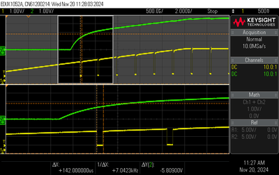

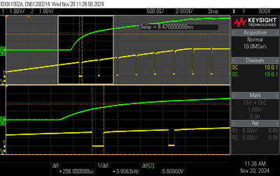

On the oscilloscope it looks like the screenshots below.
Respectively from the screenshots, it can be observed that the 1st startup(power up) takes 254 μs while the 2nd startup (IWDG reset) takes 132 μs.
Now if uncommenting this line GPIOB->MODER &= 0xffff3fff; and redo the measurement, we get the results below.
We can see that having the GPIOB pin 7 set to input reduces the startup time from 254 μs to 132 μs and the rest startup remains taking the same time.

The scope pictures are as follows:
At what voltage does the first edge happen? For me it seems this is below minimum V(POR) = 1.9 Volt and probably also below minimum V(PDR) = 1.88 Volt . This would mean that the part is outside the "5.3.3
Embedded reset and power control block characteristics" specs. And "5.3.1 General operating conditions"  and so the whole part is only specified for operation from minimum V(PDR)  up to 3.6. Volt.
So the question is: Why does your part work below minimum V(PDR at all!
Why are green and yellow voltages different? Are external pull-ups used on MCO and GPIO? Why the dropouts on MCO when GPIO is low? Show your schematics!
