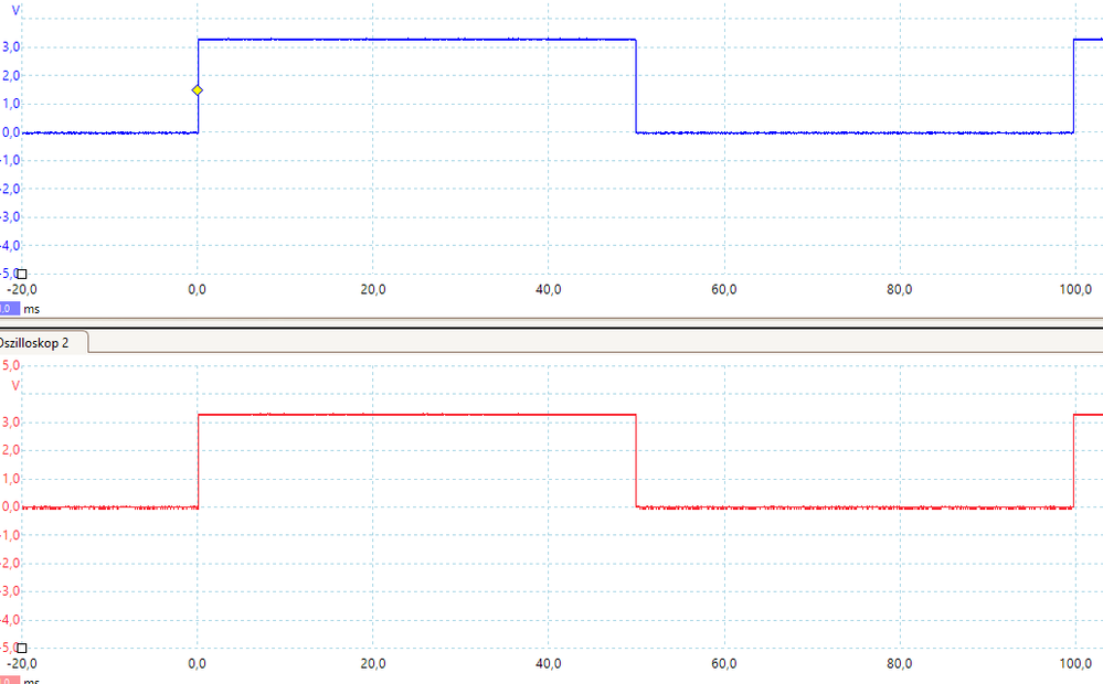

I am trying to set up two timers so that they generate a PWM with the second timer being 1/4 phase past the first one. I am using an STM32F446.
I have the second set up as slave and triggered by the OCREF2 of timer 1, this should then generate a reset of timer 2. Below is my timer init by cube mx and I'll also post the registers.

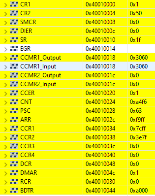

}The registers after initialization look as follows:
TIM1
TIM3
With this setup my signals are just in phase, with the second one just 40us behind, which you cannot see in this snap

2022-07-12 8:20 AM
I worded that badly, the registers look like that after starting the counters, before that they are completely set up. The timers are then started with a call to HAL_TIM_PWM_Start(...) which does exactly what you described (omitting the enable for the triggerd counter). Still the waveforms are in phase
2022-07-12 9:04 AM
Show.
2022-07-12 9:15 AM
TIM1 after call to MX init
TIM3 after call to MX init
