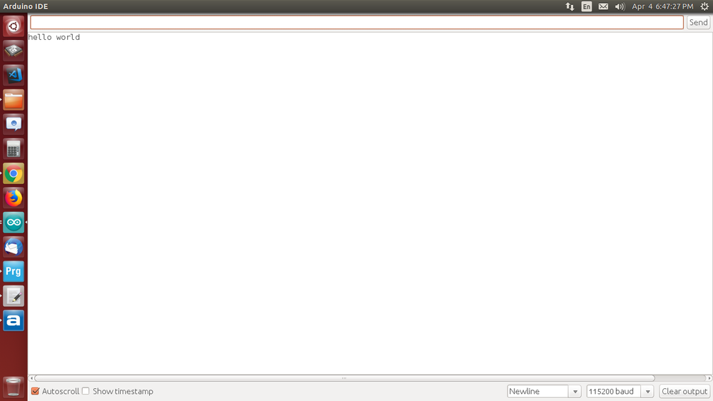

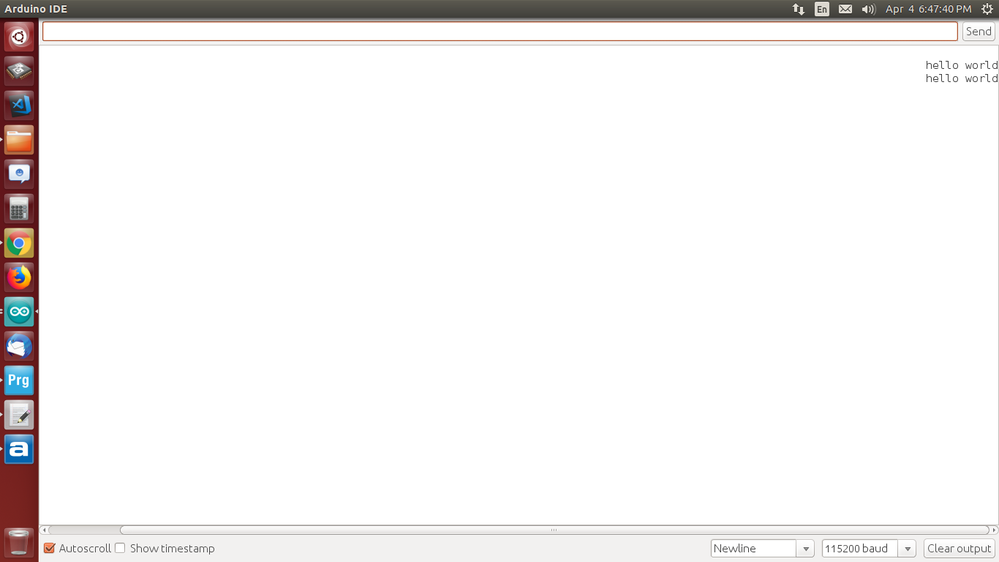

2019-04-04 6:21 AM
Now I am able to receive data on uart 2 and display on PC's serial port.
But there is a long space between 2 data.
Please help me to solve out this I also attached snaps.
For an example, I send three times ''Hello world " from pc's serial port and STM32 reflect back on pc's serial but there is a long spaces between two data.
I share my receive callback function and snap of serial port of PC.

What do you mean by "a long space between 2 data" ? is there some time between typing "Hello world" in your console, and seeing it printed back ?
Could you try to use Rx complete callback, only to catch the information of Reception sequence completed, and to perform buffer reset, buffer analysis + scheduling of new HAL transactions (Transmit, and/or next reception) out of HAL_UART_RxCpltCallback callback ?
Please remind this callback is executed in Interrupt context.

Or that the HAL simply fails to do the job adequately? It is over engineered, and STILL doesn't manage buffering properly and is apt to fail or block rather than add data to a queue. More examples help in most cases, here the basic paradigm is broken.
#NotFitForPurpose
2019-04-15 9:30 AM
The use of HAL_UART_Transmit_IT() takes no account of the disparity in size between the output and the frequency of the callback, nor if a current request is already pending, or recovering if an error is returned.
The whole HAL UART subsystem is VERY POORLY conceived and doesn't fit well with any normal buffering and processing scheme. Interrupt processing needs to be simple and elegant, and not dwell for multiple byte times on a system with NO internal FIFO. The "callback" hides the fact it is called in interrupt context so the user imagines they can perform complex tasks, which in reality need to be posted for some worker task to consume.
