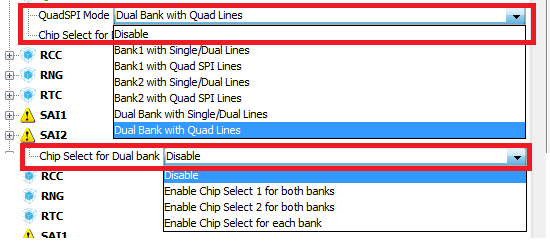

I want to interface 512Mbit or 1Gbit I with STM32F722VET6 with CubeMX . I have seen lots of option for interfacing ..
Which option I need to select for below memory chips in Quad SPI Mode , Bank (s) and Why ?.

Use MX25L51245G select "Bank1 with Quad SPI Lines" item.
STM32F769I-Discovery on board mount this chip. BSP driver was ready.
STM32 MCU support 2 sets QSPI interface. "Dual bank" means system will connect 2 Flash to those interface.
When you use Dual bank, MCU will access one Flash by odd address the other one by even address. Access Flash will use same command at the same time.
