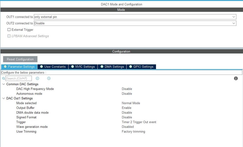

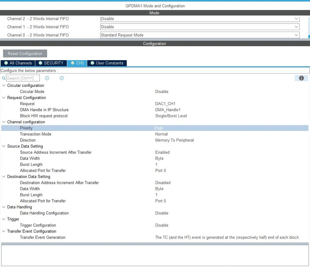

Here's the challenge; the chip fails immediately with a DMA_FLAG_DTE error, with the trigger overrun flag being set in the CSR. No idea why or where to go next after 2 days of trying to troubleshoot this. Here is the MXCube configuration:
In the code, there is a simple 8Khz WAV file stored in the "tinkles" array. Using the standard generated code from MXCube, I have attempted to just play it out the DAC with the following calls:
HAL_DAC_Start_DMA(&hdac1, DAC_CHANNEL_1, (uint32_t*)tinkles_wav, tinkles_wav_len, DAC_ALIGN_8B_R);
HAL_TIM_Base_Start(&htim2);
It *is* an 8-bit array, and I am not sure if that may be part of this. Here is the code:

Figured it out. The DMA_FLAG_DTE error is thrown when the source and destination address in the DAC_Start_DMA call is not expressed as a 32-bit pointer.
