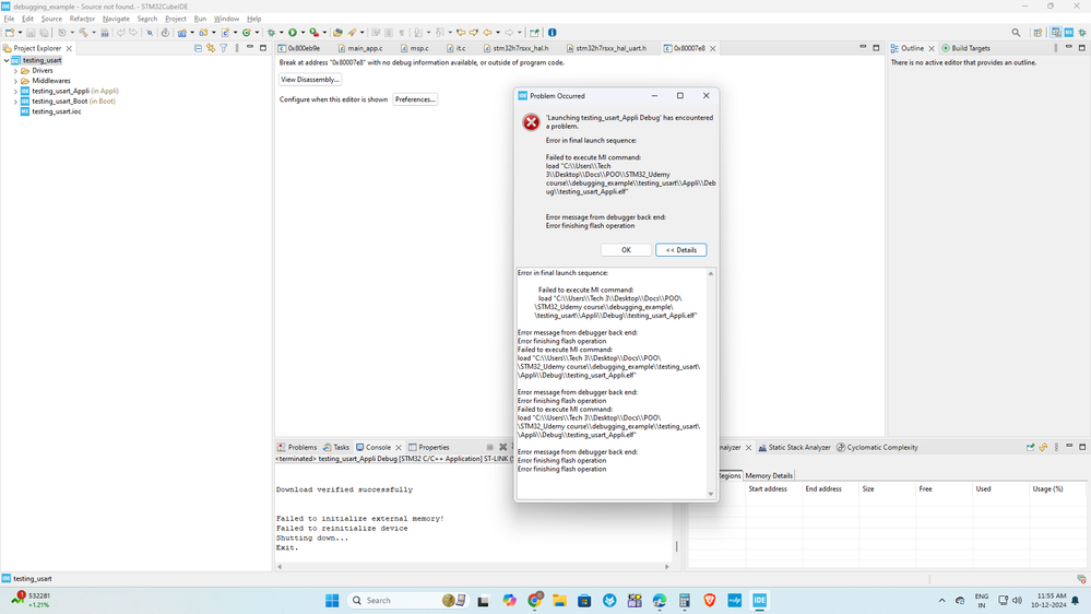

Hello alister,
Greetings from pooja.
I am working on the USART exercise as per your suggestion using the NUCLEO-H7S3L8 board with STM32CubeIDE. I'm facing a similar issue. As suggested earlier, I updated the debug configuration to write my application code to an external loader for storing it in external flash. However, I am encountering an error: "Failed to initialize the external memory," and the reset option is also not functioning. I would greatly appreciate any assistance in resolving this issue.
Thank you!
2024-12-10 4:34 PM
This isn't what halfordC's posted about and should be a new thread.
Not reading 1MAIN_APP.C because I'm guessing the problem's occurred before the app executes.
I don't know why your app's debug configuration's external loader (uses STM32CubeProgrammer) is failing.
