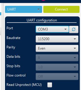

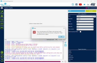

After setting up the boot configuration, I attempted to connect the STM32's UART using a TTL converter and the STM32CubeProgrammer software (Win64, versions 2.18.0 and 2.5.0). However, I encountered some issues, and I have attached a snippet showing the error.

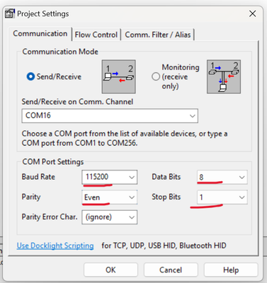

1. TTL Converter:
The TTL converter is working correctly. Before attempting the boot method, I verified its functionality by running a UART communication test application. The test confirmed that the TTL converter is operating without any issues.

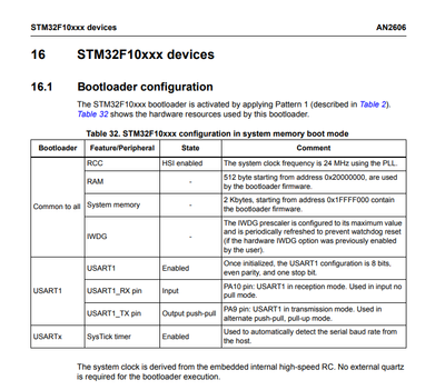

2. Boot Configuration:
I followed the bootloader configuration details for STM32F103C8T6 as outlined in the AN2606 document, specifically under the STM32F10xxx devices section. I used Pattern 1 for the boot configuration. Below are the steps and connections I made:

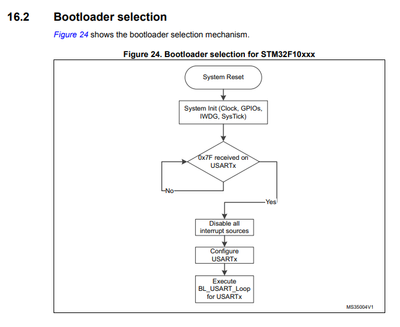

After this setup, I sent the 0x7F command to initiate communication but did not receive any response. Additionally, I could not establish a connection using the STM32CubeProgrammer software.
Refer to the attached images for further details.
