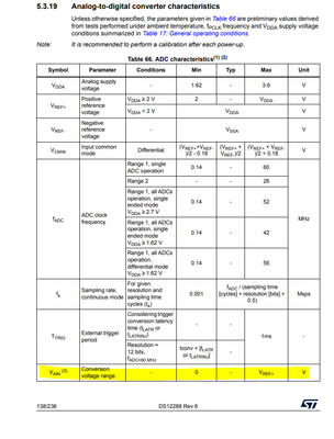

Hello @Erwin_N
The 3 values are just the 3 output voltages supported by the Internal voltage reference buffer VREFBUF. For the Conversation voltage range it should always be between 0 and Vref+ as mentionned on the Datasheet - STM32G474xB STM32G474xC STM32G474xE - Arm® Cortex®-M4 32-bit MCU+FPU, 170 MHz / 213 DMIPS, 128 KB SRAM, rich analog, math acc, 184 ps 12 chan Hi-res timer

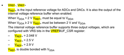

2024-12-04 7:02 AM
I read that VREF+ supports 2.048V 2.5V and 2.9. so i read that as if the VREF is one of those 3 voltages. so the conversion voltage range goes from 0 to one of those 3 voltages right?

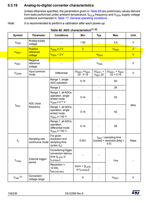

2024-12-04 7:50 AM - edited 2024-12-04 7:56 AM
As you can see on the tab 66 of the same datasheet i've mentionned before Vref+ is equal to VDDA if VDDA < 2V and Vref+ is between 2 and VDDA if VDDA => 2V.:
PS: VREF+ can be provided either by an external reference lower than VDDA of by an internal buffered voltage
reference (VREFBUF).

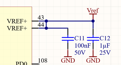

2024-12-04 10:50 PM - edited 2024-12-04 11:26 PM
So. You say that VREF+ can be anything in between 2V and the supply voltage (if it is bigger than 2V), but you also say that VREF+ can be provided by an internal buffered voltage.
Also, why are there 2 VREF+ connections
i
i am a little confused
