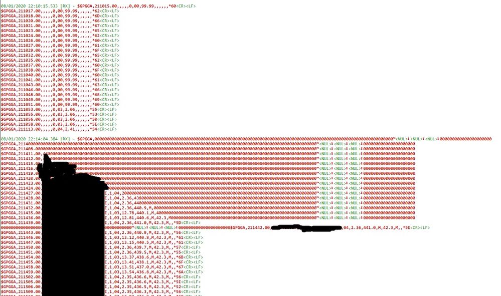

Hi everyone, i'm using uP STM32F103C8T6 processor and GPS module NEO M6Q with standard uart configuration on 9600 baud-rate .
I enable global UART2 interrupt to receive data from GPS module on every second. But for some reasons, interrupt starts skipping data from GPS module and some data are lost. Also, some times it's just stop working, not the whole device but only UART2. When I receive data to buffer, I parse out GPGGA data and send it out with USB to dock-light.
Does any have idea how to fix this, or maybe have solution for this problem.

2020-01-08 9:56 PM
few thoughts:
GPS_Variable.GPS_UART_RECEIVE is filled by the USART hardware asynchronously. So you cannot read it in the while loop and expect data integrity. This needs synchronization.
Your pattern of using the interrupt is unusual. You should not call HAL_UART_IRQHandler(&UART2); and HAL_UART_ErrorCallback(&UART2); See my comment in HAL_UART_Receive_IT
Without intervention, HAL_UART_Receive_IT(&UART2,GPS_Variable.GPS_UART_RECEIVE,256); calls HAL_UART_RxCpltCallback only after having received 256 bytes. This might be too late ?
Although interrrupt (plus DMA ?!) is more (most) efficient, the code gets more complex. If your while loop doesn't do much more, why not simply using polling (HAL_UART_Receive) ?
