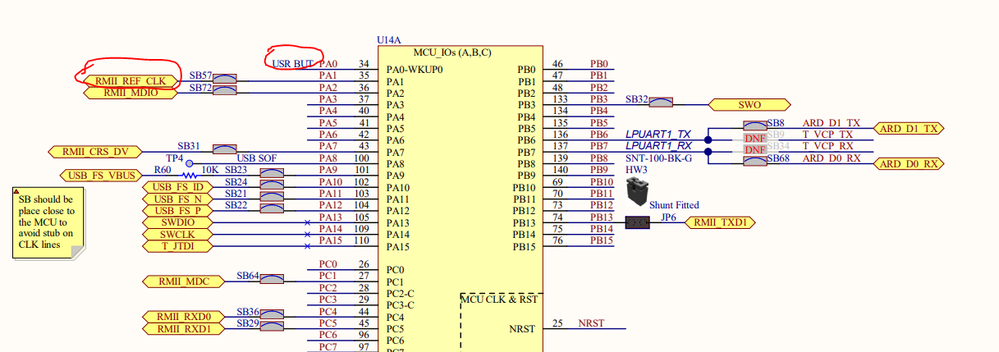

So I checked board's schematic as following;
I saw that PA1 and PA0 are not directly connected to CN11 connector in the board.
Is it causing UART4's transmission and reception error?
Also if I want to operate UART4 using GPIO's PA0 and PA1 only, what is the solution?

Before going further, you can test with another alternate function not mapped on PA0 even it will not be your final design and check if the problem persist.
Ps: I think there is a capacitor connected to PA0 used for for button debouncing it could introduce some communication issues and does a signal filtering.

You need at least to remove SB57.
Seems your UART is disturbed by the clock coming from ETH PHY.

Thank you for replying.
I understood that for PA1 (rx pin) I might have to desolder SB57.
But what might be problem in PA0 (tx pin)?
