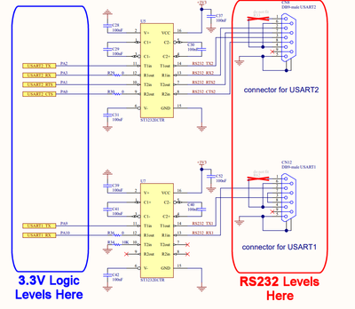

@waclawek.jan wrote:As @Tesla DeLorean said, the problem is that you are looking at the signal on the DB9 connector of the EVAL board, *after* a RS232 convertor. RS232 has different levels than 0-3V, and is inverted.
@rahul7515 you can see this clearly in the board schematics:
https://www.st.com/en/evaluation-tools/stm3210e-eval.html#cad-resources
https://www.st.com/en/interfaces-and-transceivers/st3232c.html
