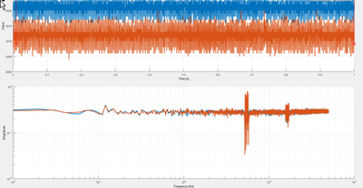

We use a STM32F7xx microcontroller with LQFP144 case
Part of the ADC Pins are on the 1-36 pin side.
Unfortunately this is also the side where the Quartz (Pins OSC_IN and OUT, PC14-OSC32_IN, PC15-OSC32_OUT) and the RMII_CLK are mapped.
This leads to additional noise (app. 10 LSB with peak regions at 500 Hz compared to 5 LSB noise on other similar filtered sensor signals) on the pins 36 (ADC123_IN2) and 37 (ADC123_IN3) despite anti-aliasing filter.
Unfortunately we could not find any other pin available on ADC1 and ADC2.
Is this a well known problem that oscillators may disturb ADC's of STM32Fxxx microcontrollers?

Hello Amel,
Thanks very much for having answered so quickly.
The annoying additional noise is not a general issue for all ADC pins.
We have 6 sensor signals connected to ADC Pins.
2 of them show additional noise.
They are connected to PA2 (Pin 36 of STM32F756ZG in LQFP-144 case) = ADC123_IN2 and PA3 (Pin Nr 36).
PB0 = Pin 46 = ADC12_IN8 gave better results
but PC0 = Pin 26 = ADC123_IN10 or PC2 = Pin 26 = ADC123_IN12 gave no better results.
Is this worth trying PC1 or PC3 = Pin 29, too ?
Layout does not seem to be the problem but more to which ADC pin the sensor signal is connected.

I measured the noise without anything connected to the input stage composed of anti-aliasing filter and voltage adaption circuit.

Hello AScha.3,
Thanks for your contribution that makes sense.
Some more details about our HW and FW implementation:
1) STM32F756 has 3 ADC's with 12bit resolution.
=> 1 LSB corresponds then to 0.8 mV
2) Within our actual FW the sampling frequency is 10 kHz per channel.
3) The LQFP-144 case is a square form.
The side with pin nr's 1-36 receive the 2 quartz (CPU main clock and RTC Clock) and outputs the RMII clock for Ethernet connection.
4) The 2 (more) noisy ADC inputs are also on this side.
5) PA2 = ADC123_IN2 = Pin nr 36 is next to PA1 = RMII_CLK
6) Connection distance between last filter stage and PA3 = Pin nr 37 is very short (3.3 mm) and is crossing nor getting along no other signal.
6) DSP law: When aliasing occurs the digitalized signal is unrecoverable
