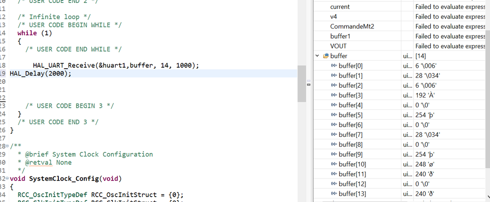

in polling mode, the receiver works well but remains different from what I expect2024-01-11 8:37 AM
You're all over the map. First you post a screenshot that shows your buffer of 10 are all zeros and now you're showing a buffer of 14(?) with data.
2024-01-11 8:41 AM
no first is with interruption mode ..there is no data..but now i'm using polling mode

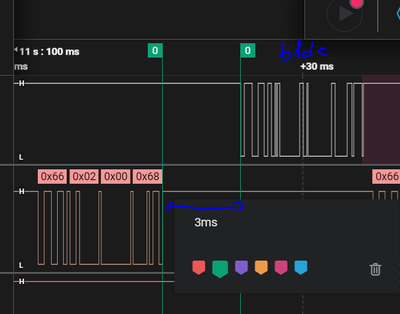

I looked with a LOgic to analyze the frame sent by stm32 and received by BLDC: I see that when I reduce the delay to 10 ms, I can receive data but not the exact expected frame
void sendParameter(uint8_t parameter)
HAL_UART_Transmit_IT(&huart1, senddata, 4);
HAL_Delay(100);//reduce the delay to 10 ms,
2024-01-15 7:04 AM
HELLO,I resolved the problem and I want to share the solution with you: the issue is with the RX is always pulled down by the BLDC,, just I changed the brushless controller and all is ok
