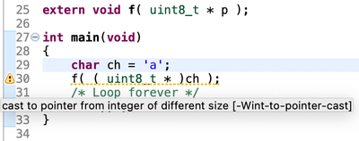

2026-03-27 3:57 AM
Unfortunately, the mistake was masked by the (uint8_t*) cast - without that, you'd have got a compiler warning...
2026-03-27 4:42 AM
@Andrew Neil wrote:Unfortunately, the mistake was masked by the (uint8_t*) cast - without that, you'd have got a compiler warning...
GCC does generate a warning for it:
