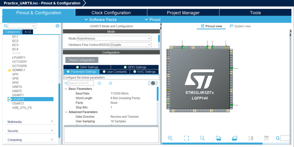

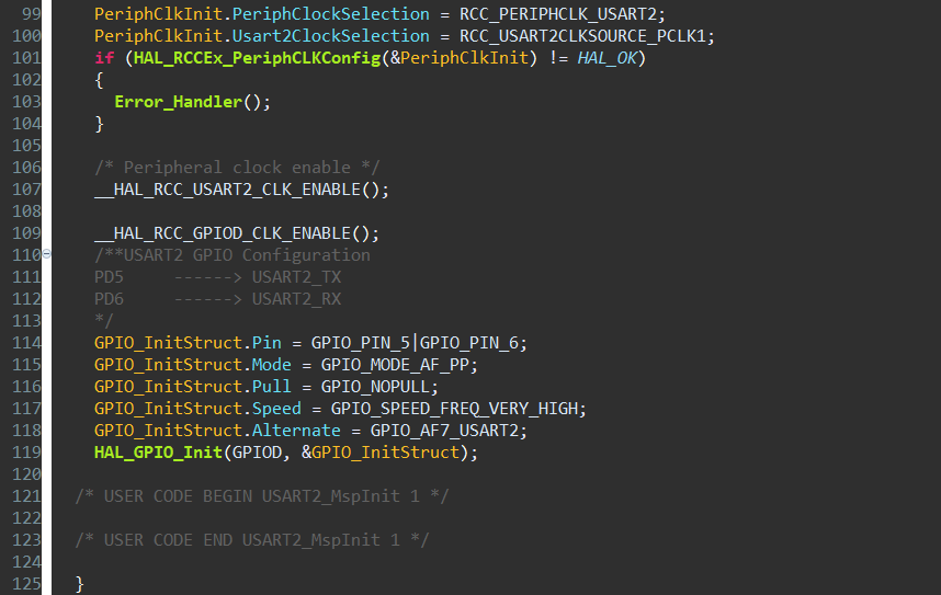

Hey everyone. I am trying to print something on TeraTerm console using USART2. I am using STM32L4R5ZI board for this function. Below is a picture of my .ioc file:

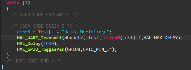

Below is the Code in my while(1) Loop:

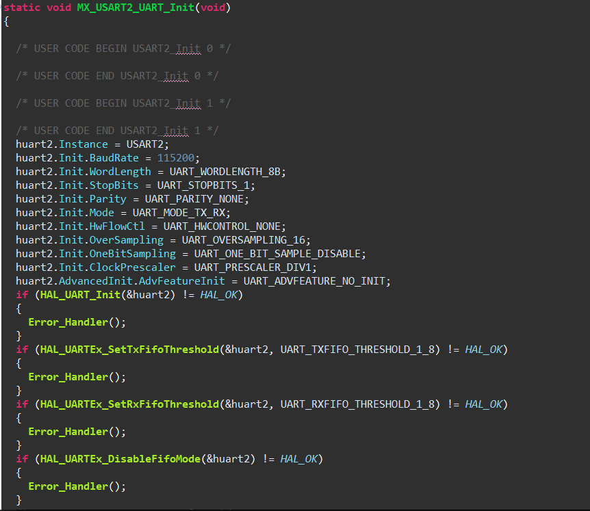

Below is the configuration for USART2 in main.c file and msp_c:

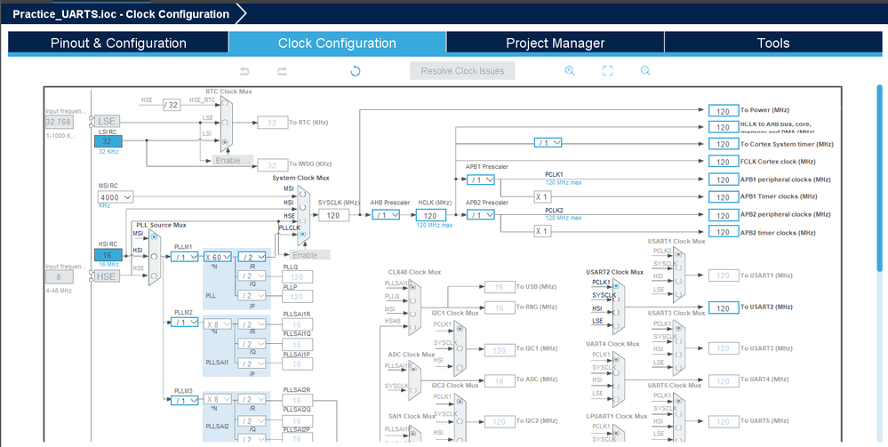

Finally, this is my clock configuration for this project:

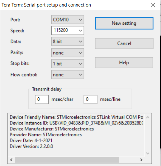

My teraterm settings are as follows:
I am trying to send some data to TeraTerm. However, nothing is being printed out.

When posting code, use the </> instead of screen shots
Use strlen instead of sizeof for strings. Don't use HAL_MAX_DELAY as that is ~49 days before it returns from a timeout. 100ms will suffice.
You don't check HAL status to see what could be the issue.
HAL_StatusTypeDef hal_status;
hal_status = HAL_UART_Transmit(&huart2, Test, strlen(Test), 100);
if(hal_status != HAL_OK)
if(hal_status == HAL_TIMEOUT)
// do something
else if(hal_status == HAL_BUSY)
// do something
else if(hal_status == HAL_ERROR)
// do something

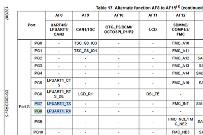

2025-05-23 1:02 PM

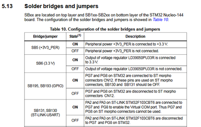

Are you using a NUCLEO-L4R5ZI board?
Default solder bridge connects to PG7 and PG8.
2025-05-23 1:09 PM
Not USART2...
2025-05-23 5:56 PM
Thank you. I knew that PG7 and PG8 were the terminals for my terminal. However, I was following a lot of tutorials on YouTube, and most of them were using USART2. That's why I was using it.
Anyways, Thanks for the help. Appreciate it @Chris21
