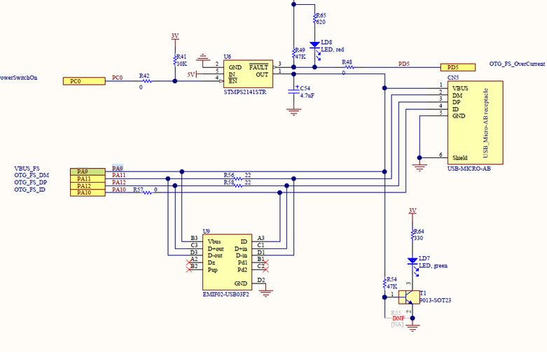

PA9 and PA10 are connected to the USB circuitry. When working with development boards, you need to make sure the pins you are using are not connected to other circuitry.

PA9 and PA10 may be used for some purpose on the Disco board, review the schematic / user manual.
