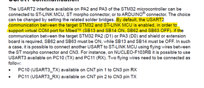

Thanks for taking your time and Interest in Solving the Issue, I figured the Solution for this problem, I was using USART2 peripheral but i did not know SB62 and SB63 Are by default OFF(means
I got the Above Information from User Manual of STM32F401RE,
So in my Implementation I used UART6 Peripheral instead of 2, So i'm receiving the data on ESP32

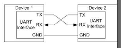

Provide a wiring diagram. Output from STM32 needs to go to input of ESP32, need common ground.
2023-11-12 1:54 AM
Hello Thanks for the reply
I followed the wiring Connections as mentioned in the above image Where Device 1 is STM32 and Device 2 is ESP32, Both the devices are powered using PC USB Port

Manual for NUCLEO-F401RE board, the STM32F401RE is a chip.
It would be good practice moving forward to identify exactly what boards and hardware you're using, with enough specificity a manual could be found.

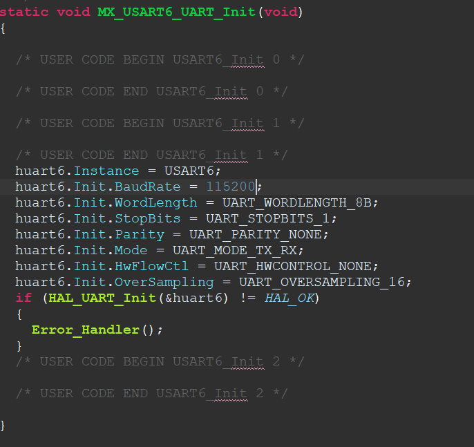

@mast3rshinobi @Tesla DeLorean iam facing the same issue, receiving garbage value, could you please share clock configuration and USART6 details for your board ? iam using STM32f407vet6 board USART6 with half_duplex (Only transmit)
thanks & regards

If clocking from an external source (oscillator or crystal, HSE), make sure the the HSE_VALUE in stm32f4xx_hal_conf.h is reflective of the correct speed. Otherwise the baud math is broken.
Send a constant stream of 'U' or 0x55 bytes, and scope the UART_TX signal to confirm the speed you're actually transmitting at.
If you're transmitting properly, check the receiver..

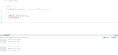

2025-07-07 10:52 AM
I have tried this uart6 and the same code as yours. but still its printing some gibberish characters. Can anyone rectify this error.
