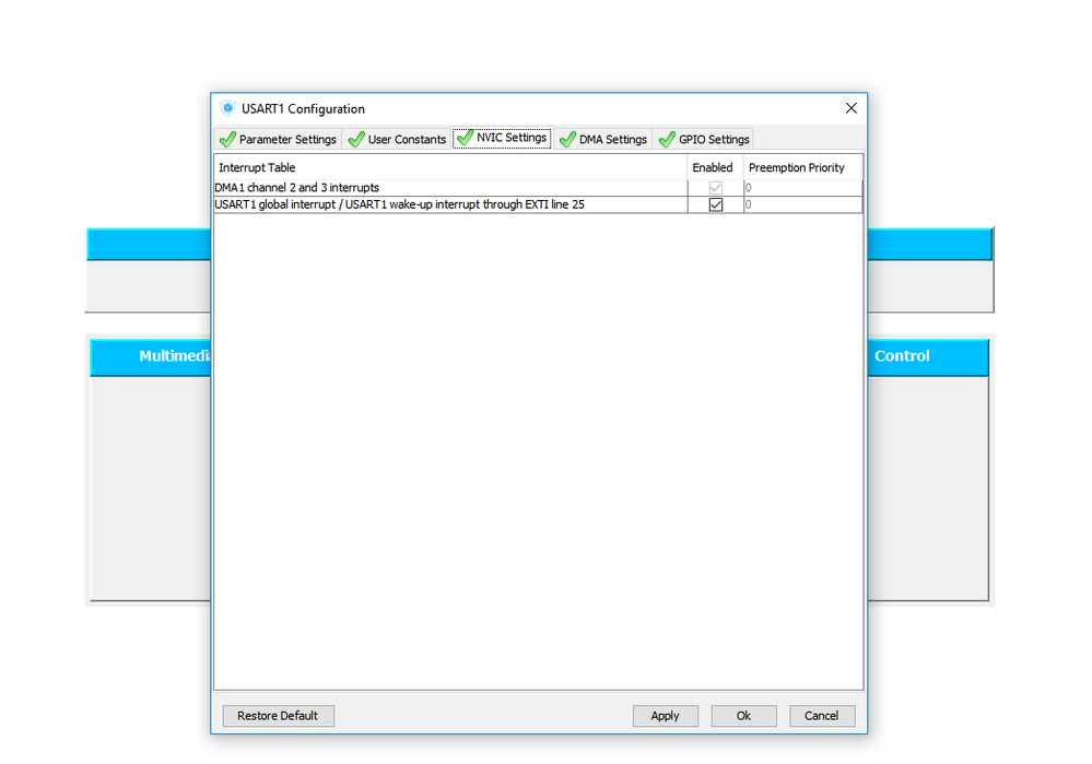

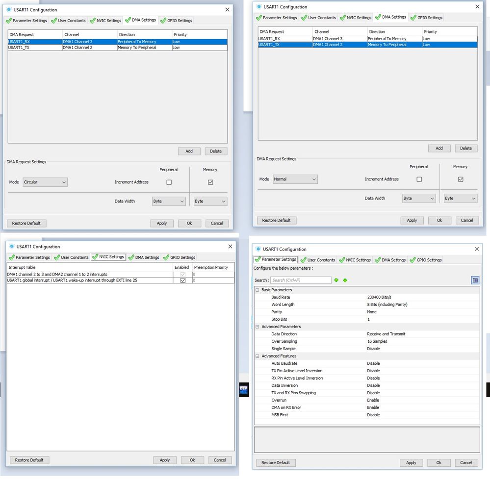

Thank you for your reply. I should have given more information. I apologize. I am using the discovery board for the stm32f072rbt6. I am trying to use the dma function to send values from the adc to my computer. It does work without dma (only hal_transmit_fs) but not with it.
To answer your questions. I did enable the Uart interrupt via Cube and I did start the dna. My main is attached to the original question as a text file. But just to be sure I have attached the settings below.
//start dma
HAL_UART_Transmit_DMA(&huart1, (uint8_t *)bufftr, sizeof(bufftr));
//Interrupt settings

In the cube, you can enable an interrupt with a checkbox, the cube sets it up in your initialization code.
I had to check the Uart1 interrupt before the DMA would function correctly.
For some reason HAL seems to need it.
I didn't add anything to the Uart interrupt,.
not sure why.
so much to do, I just moved on.
in another thread, This was the final fix for DMA Uart functionality. ( suggested by another engineer)

Thank you for your reply and sorry my late response. I tried setting it up as suggested, however it still does not work.
I will try to find a oscilloscope to test if data is actually being sent. Also, I set the device up as a CDC usb device. Could that be the reason why it does not work? I tried to do it without, however I am unsure how to receive the data on my computer without a virtual com port.We’re moving the ST Community to a new platform to give you a better and more reliable community experience.
