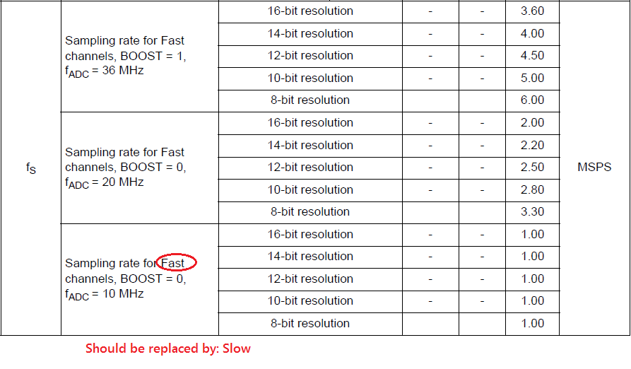

2018-05-03 2:33 AM
I applied to ST online technical support and their response was:
''In fact there is a typo in the datasheet. ''Fast'' should be replaced by ''Slow''
in the last line in the table in the datasheet as shown by the attached image.
This will be corrected in the next version of the datasheet.''
2018-05-05 9:44 AM
Thank you! Does anyone know the timeline for the next datasheet version?

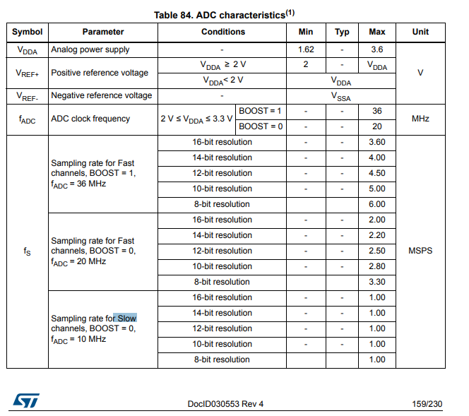

2018-06-07 4:44 AM
We corrected this typo in the ''ADC characteristics'' table for the STM32H753xI datasheet Rev4 which is available since 18-May-2018.
Thank you for bringing this issue to our attention.
With Regards,
Imen
