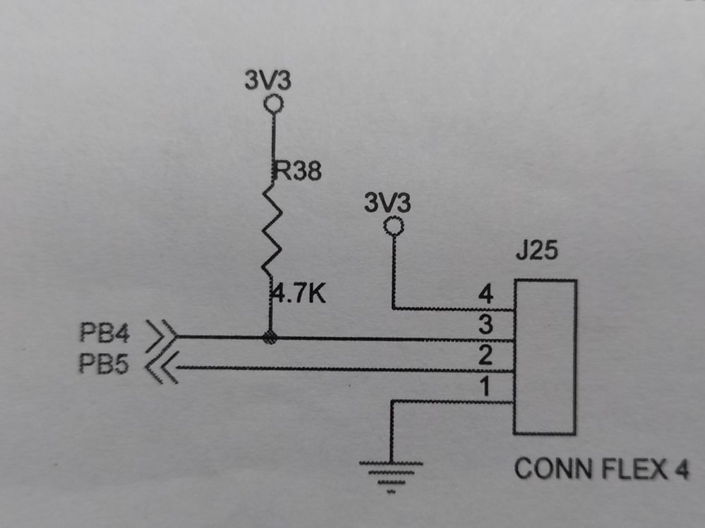

So the PB4 / PB5 is on the STM32F446RE or something else?
Which UART
What is wired to what, diagram the actual connectivity, perhaps the initialization code.
What does "The communication is not smooth" mean? You're sending NUL characters in the very limited code snippet you've chosen to share.

You need to show your full schematics, and your code - see:
