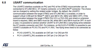

The problem is, I am setting the default UART pin (PA2 & PA3) as Tx and Rx, but the data is being sent via the USB port.

Ooooo - i didnt know this. You cannot use the uart pins on the nucleo board, that are fix wired to the st-link onboard !
Use another uart (you have MANY here! ) or define some FREE pins (in the ioc edit ) to be used for rx/tx , then it will work.
2024-01-19 2:05 AM
@AScha.3 wrote:You cannot use the uart pins on the nucleo board, that are fix wired to the st-link onboard !
Indeed - much like Arduinos!
It's described in the User Manual for the board - including how to break the connection, if you wish:
@AScha.3 wrote:Use another uart (you have MANY here! )
