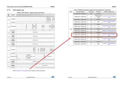

I have a question regarding STM32L0. I am interested in which address the registers like FLASH_ACR, FLASH_PECR, etc., are located. In the datasheet, I only see their offsets, but not the absolute value is it maybe 0x1FF8 0000?.

Have you checked the Reference Manual for your stm32L0?
For stm32l0x1 for example, it is stated in section 2.2 "System and memory overview:Memory organisation"
Table 3. STM32L0x1 peripheral register boundary addresses(1) (continued)
RM0377
Bus | Boundary address | Size (bytes) | Peripheral | Peripheral register map |
NVM | 0X0800 0000 - 0X0802 FFFF | up to 192 K | Flash program memory | - |
0x0808 0000 - 0x0808 17FF | up to 6 K | Data EEPROM | - | |
0x1FF0 0000 - 0x1FF0 1FFF | 8K | System memory | - | |
0x1FF8 0020 - 0x1FF8 007F | 96 | Factory option bytes | - | |
0x1FF8 0000 - 0x1FF8 001F | 32 | User option bytes | - |
1. Refer to Table 1: STM32L0x1 memory density, to Table 2: Overview of features per category and to the device datasheets for the GPIO ports and peripherals available on your device. The memory area corresponding to unavailable GPIO ports or peripherals are reserved.

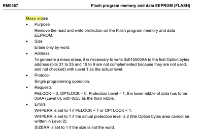

This is exactly what I was looking for, Unfortunately I still can not make mass erase of my MCU. I found this: It should erase MCU when is in Level1
So I made it

SECTION_USER_OB = 0x1FF80000
FLAHS_OB_BASE = 0x40022000
FLASH_PECR = FLAHS_OB_BASE+0x4
FLASH_PEKEYR= FLAHS_OB_BASE+0x0C
FLASH_OPTKEYR = FLAHS_OB_BASE+0x14
FLASH_OPTR = FLAHS_OB_BASE+0x1C
FLASH_PRGKEYR = FLAHS_OB_BASE+0x10
FLASH_SR = FLAHS_OB_BASE+0x18
def massErase(self):
self.unlockOptionBytesArea()
self.programoptionBytes(0x00AA)
def unlockOptionBytesArea(self):
self.busy_wait()
tmp = self.readU32Mem(FLASH_PECR)
if (tmp & PECR_PELOCK_BIT) == 0: #
if tmp & PECR_OPTLOCK_BIT == 1 :
if self.writeU32ToMem(FLASH_OPTKEYR,OPTKEY1) == True:
if self.writeU32ToMem(FLASH_OPTKEYR,OPTKEY2) == True:
self.busy_wait()
return True
def programoptionBytes(self,val):
val = self.option_bytes_word(val)
self.writeU32ToMem(SECTION_USER_OB,val)
self.busy_wait()
flash_sr = self.readU32Mem(FLASH_SR)
if flash_sr & SR_EOP != 0:
self.writeU32ToMem(FLASH_SR, SR_EOP)We’re moving the ST Community to a new platform to give you a better and more reliable community experience.
