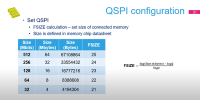

Thank you for the input, I was referring to the QSPI loader series on ST's YouTube page and took the flash size calculation from there. Just to clarify, the device size calculation is different for QSPI and OSPI peripherals, correct?

Yes you are right.
About the QUADSPI configuration in STM32CubeMX, the Flash Size= FSIZE when FSIZE is calculated according number of bytes in Flash memory = 2^[FSIZE+1].
About the OCTOSPI configuration in STM32CubeMX, the Device Size defines the memory size in number of byte. So, number of bytes in Flash memory = 2^[Device Size] = 2^[DEVSIZE+1].
