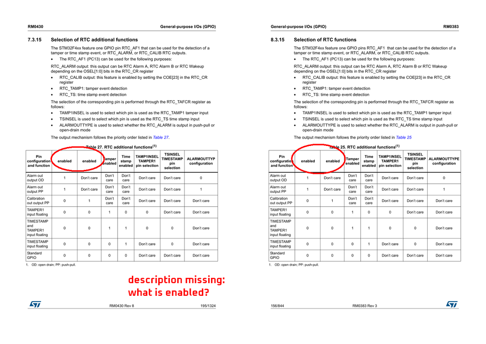

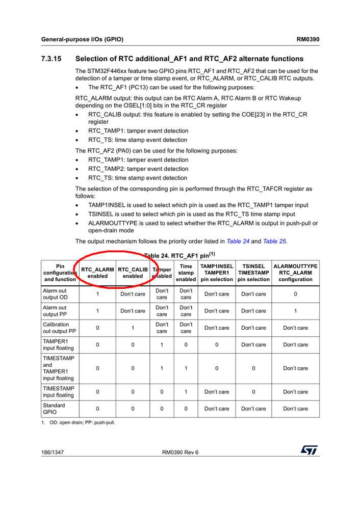

Thank you for bringing these typos to our attention and I reported internally.
Internal ticket number: 147877 (This is an internal tracking number and is not accessible or usable by customers).

Hello @Community member ,
Thank you for reporting this typo.
I confirm that and I will check internally.

Thanks, Kaouthar.
