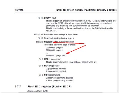

Hello @Tobe and thank you for reporting this.
I will check this internally and come back to you as soon as possible.

8-bits
/* Proceed to erase the page */
MODIFY_REG(FLASH->CR, FLASH_CR_PNB, ((Page & 0xFFU) << FLASH_CR_PNB_Pos));
SET_BIT(FLASH->CR, FLASH_CR_PER);
SET_BIT(FLASH->CR, FLASH_CR_STRT); }

Hello @Tobe
In fact, the Flash memory (FLASH) for category 2 devices is a 128 Kbyte single bank memory with a page size of 2 Kbyte. That means we have 64 pages (page 0 to page 63). So, you need only 6 bits.
Internal ticket has been created to correct the typo in the next release.
Internal ticket number: 169676(This is an internal tracking number and is not accessible or usable by customers).
Sorry for my late feedback.
Best Regards.
STTwo-32

Hello @Tobe @Tesla DeLorean
This typo has been solved on the RM0440 Rev8.
Best Regards.
