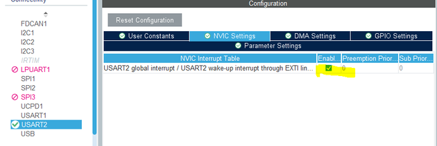

Try using interrupt method instead of polling.

Make sure you have NVIC enabled
