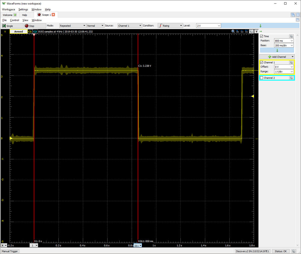

2019-03-30 4:12 AM
I have checked the LPTIM functionality with scope. It works as its supposed to. Bellow an 850 ms pulse is being generated with:
HAL_LPTIM_OnePulse_Start(lptim_handle, 850, 0);32k LSI as LPTIM1 source with /32 divider.
