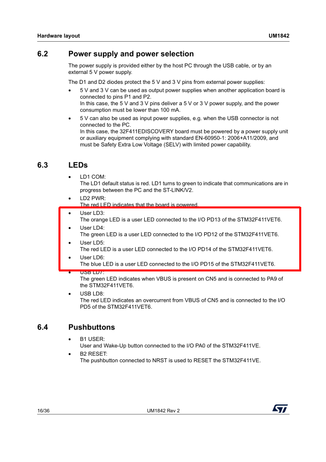

2023-03-20 4:56 AM
2023-03-20 5:02 AM
> PA13 and PA14 are the debug interface pins - not a good choice for timer outputs.
The LEDs indeed are not on PA12/13/14, but PD12/13/14/15.
2023-03-20 5:09 AM
Oh, thats a mistake in my post, I do have it set to PD12, PD13 and PD14. Edited it to correct that

1 Actually the pins have always been on PD12,13,14 - that was just a typo in my post!
