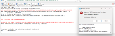

Reason: (255) Unknown. Please check power and cabling to target.
i again click resolve by accident but i can only run on core at the time in the debug
else the program work

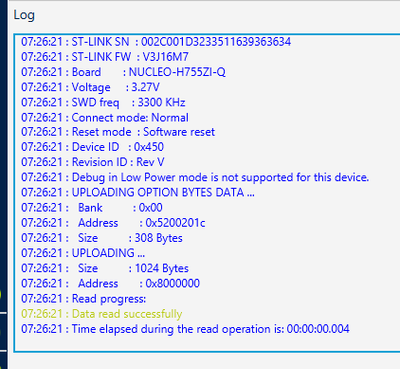

Try to connect with CubeProgrammer and tell us what do you find?

As you are able to connect with CubeProgrammer there is no issue in the HW.

Your code ran good on my Nucleo H755ZIT6U, but you were setting M4 and M7 at 61234 port, I just swapped M4 to 61238 and it debugged. For newbies, here is my understanding as I am also learning:
M4 breakdown 0xa05f0000 is not an error. See how to "stepover" in "STM32 Dual Core 1 How to debug" by ControllerTechs on Youtube. When you build (upload) to 2 cores, the M4 will sleep and wait for M7 wake-up signal. M7 sees M4 sleeping, configures all core clock, does setups, wakes M4 up first, then M7 will start working. This is why M4 LED is blinking first, then M7. To start the new code please press the Reset button.
