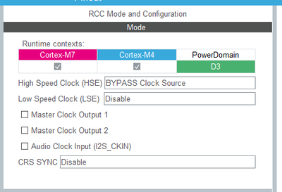

In your project you set the HSE in Crystal/Ceramic Resonator
While it should be set in Bypass mode:
With Input frequency set to 8MHz:

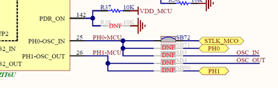

From the schematics, there is no external crystal mounted on the board:
And the frequency is generated by the STLINK MCO.

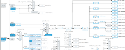

i made the changes in the ioc like you told me
i change some multipliers to get 400mhz , 200 and 100

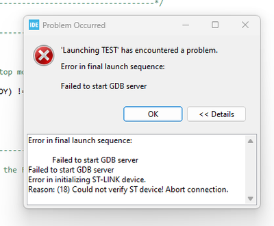

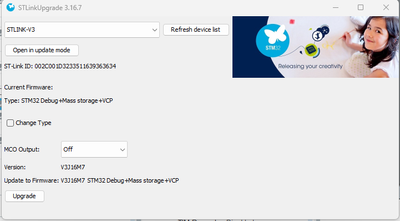

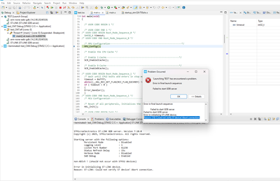

but i get this error when i try to start for infos i use the configs from
" Getting started with projects based on dual-core STM32H7 microcontrollers
in STM32CubeIDE"
i get this error now like last time

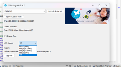

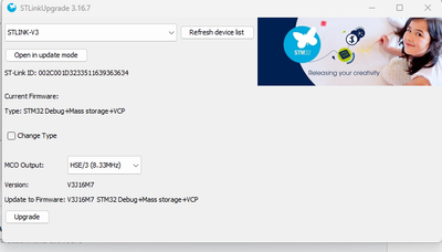

2025-03-06 1:41 AM - edited 2025-03-06 1:46 AM
i think my problem come from this i am trying on hse 8.33 if this work i will "Accept as Solution" in your reply if it works
thank you
edit

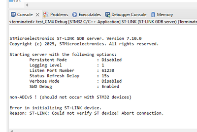

i change the mco output
and got this error

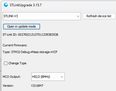

do i use the good stlink config?
do i use this
or this configuration?

2025-03-06 3:01 AM
You need to use this configuration for this board as we set the input frequency in CubeMx to 8Mhz:

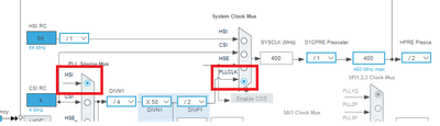

Meanwhile, in your case and to not complicate the things, as an external clock source is not needed (for example CAN or USB usage), you are just toggling a LED, so you can simply use HSI with PLL:

2025-03-06 3:05 AM
There is no HSE crystal on the Nucleo except if you have soldered one.
So just use the default configuration for STLink default configuration as said above => MCO output = HSI/2.
