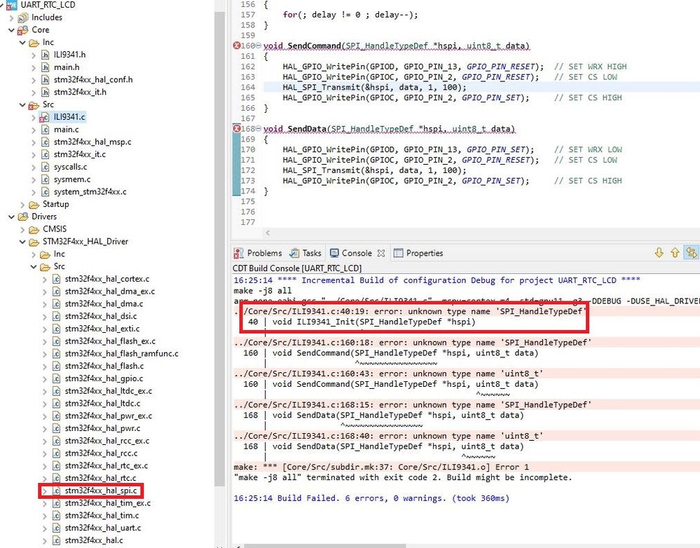

However, it seems I cannot send SPI_HandleTypedef between the main source and my library file.
My codes are not even close to the finish, but I placed in here so that maybe I have different issues that I may miss.

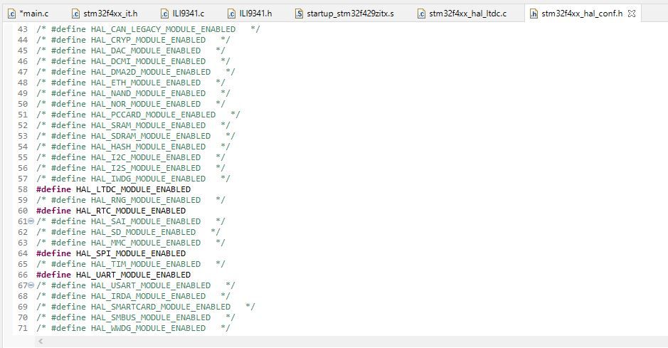

Go into stm32f4xx_hal_conf.h and ensure the SPI module is enabled.
Ensure you're including "stm32f4xx.h" before using any HAL functionality.

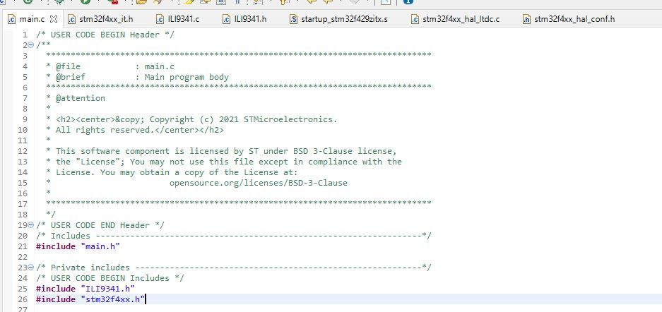

in stm32f4xx_hal_conf.h, SPI module was already enabled.
0693W00000D1JbjQAF.jpgI also include stm32f4xx.h header in my main, but It seems still giving errors.
0693W00000D1JdaQAF.jpg*I am sorry I reply too late, due to the time difference.

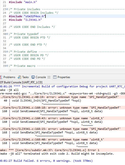

You need to include HAL functions prior to using them.
So include stm32f4xx.h before you use them in ILI9341.h.
0693W00000D1T6WQAV.jpgthat doesn't work either.
Should I write something like
#ifndef SPI
#define SPI
#endif
into ILI header file?
Well actualy, even that doesn't worked.
However, when I include stm32f4xx.h file into ILI library it erases the error.
But is it the correct way to do it this way, when I also have #include "stm32f4xx.h" at main?
