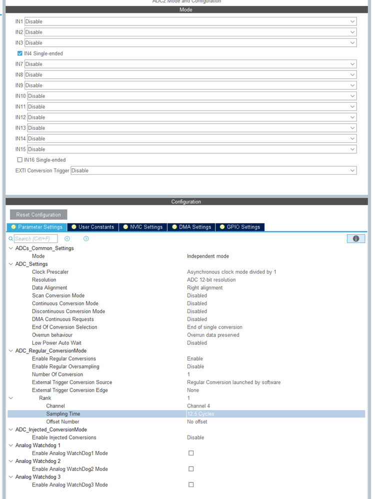

0693W000005CBx3QAG.pngHi,
I'm using both ADC's on the STM32L412KB, code is generated used the STM32 Cude with Low Level Drivers.
ADC1 works as expected, but ADC2 always reads 0, no matter in which configuration. So I'm assuming it's not a hardware fault, but a configuration issue.
In the basic single conversion mode triggered by software the EOC interrupt of ADC2 is triggered, but the Regular date Register of the ADC2 is always equal to 0.
The STM cube configuartion is attached as well as my personal configuration code:
