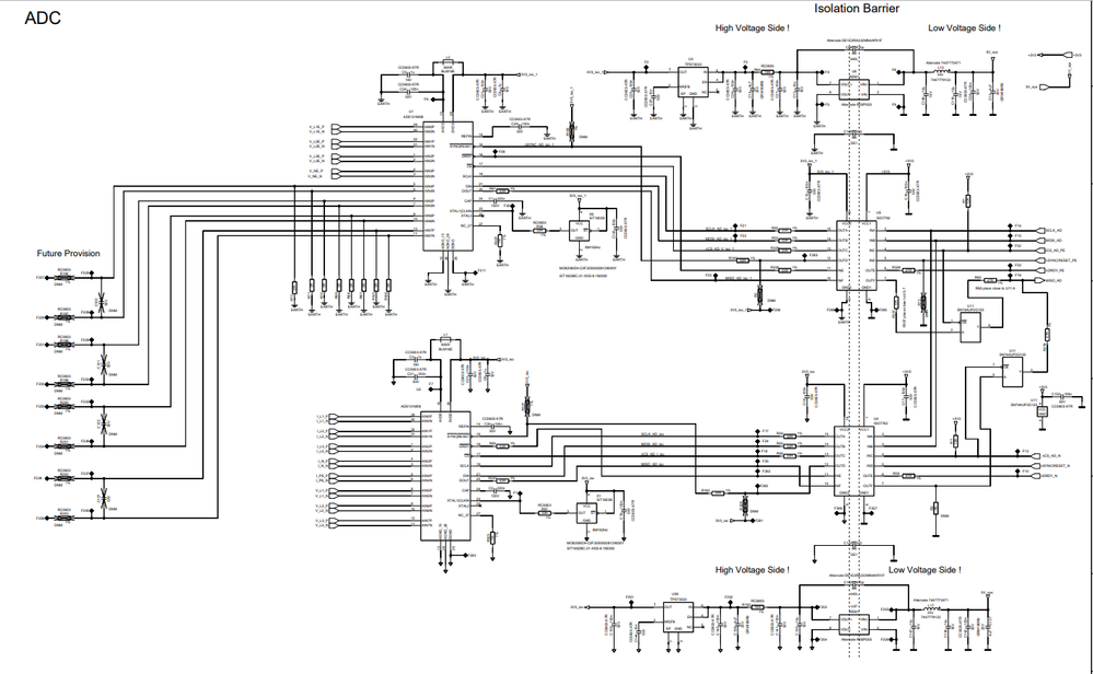

Please show your schematic.
Some good, clear photographs could help.

2025-07-25 4:42 AM
Hello Andrew,
Thanks for response.
Yes, we have communicated this issue with TI team.
As per them propagation delay of isolator is slightly different. Previously it was 16nsec and now its 18.5nsec.
Please find attached snapshot of schematic/connection diagrams for ADC and isolator.
As per your suggestions I will recheck SPI waveforms on both sides of isolator.
