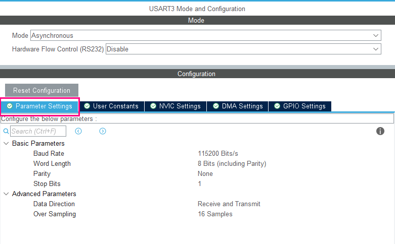

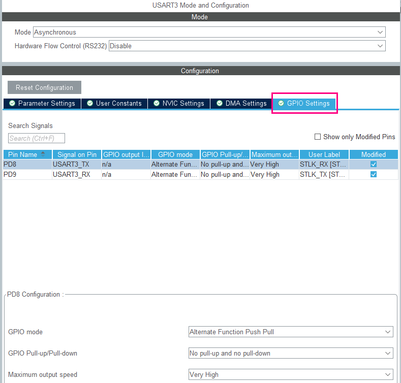

Hi @Hasan and welcome to the Community :),
Unlike the step by step tutorial, USART3 needs to be used for Nucleo-F429 (show the UM1974 and precisely section 6.9 USART communication).
I suggest you follow these steps:
uint8_t Test[] = "Hello World !!!\r\n"; //Data to send
HAL_UART_Transmit(&huart3,Test,sizeof(Test),10);// Sending in normal mode
HAL_Delay(1000);12.Check that no problem happened by rebuilding all files. There must be no error and no warning.
13.Open TeraTerm, select file>New connection and choose the right Port as shown in the below figure. 14.Select Setup>Serial port setup and connection and modify the speed to 115200 as shown in the below figure.
15.The TeraTerm displays Hello Worlds !!! string confirming you were able to program and use RS232.
