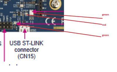

"The LD5 green LED turns ON when the voltage on the power line marked 5V is present. " its Red... and I checked a few points, there is no 5v..Maybe the 5v regulator is bad? I could supply it from another place for a test but not sure that is wise.
I also see this "6.2.1 Supplying the board through the STLINK-V3E USB port: 5 V/500 mA" section. It is set to STLK I can try usbfs.
this gives me interesting results. If I plug in the CN14 first, then CN15, unplug CN15 and plug it back in, I get two green lights.
If I plug in the CN14 first, then CN15, I get a green 5v light and a red ST com light
Neither mode works.

2023-06-30 5:04 AM - edited 2023-06-30 6:02 AM
setting to STLK give the red light and no 5v. but setting to fsusb and using a cable to cn14 works. But in both cases I can not program.
with the fsusb I get this
if the board ST link is burned out, can I use an external st0-link to program? If I remember right it has a jtag on it, I see the foot print of a jtag on this board.
